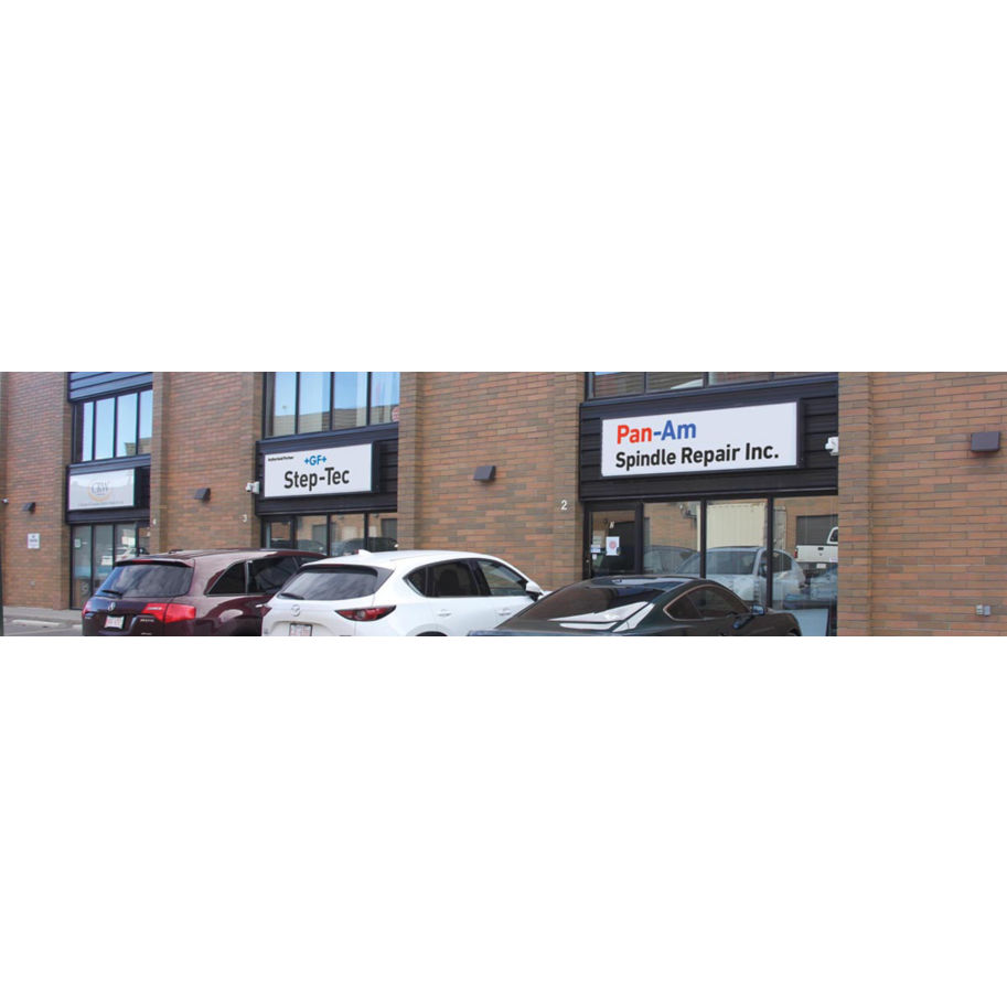

We specialize in OEM repairs, rebuilds, technical support and the sale of Step-Tec spindles. We refurbish most other spindle brands with the same dedication.
Offering sales and service for North America, our state-of-the-art facility provides the ideal environment for quality repairs. First, your spindle will be analysed. If necessary, we will do a test run before we dismantle your spindle. Then, you will receive a detailed estimate. After we receive estimate approval from you, the spindle will be assembled and driven under its own power to its maximum speed, where it will be dynamically fine balanced. After it has been tested and run for eight hours using its own motor, your spindle will be returned to you. We guarantee that your spindle will work well and that our work was done right the first time. We do not take shortcuts.
Step-Tec is your source for high-performance cutting spindles. Pan-Am Spindle Repair is your go-to for world-class repairs and service.
